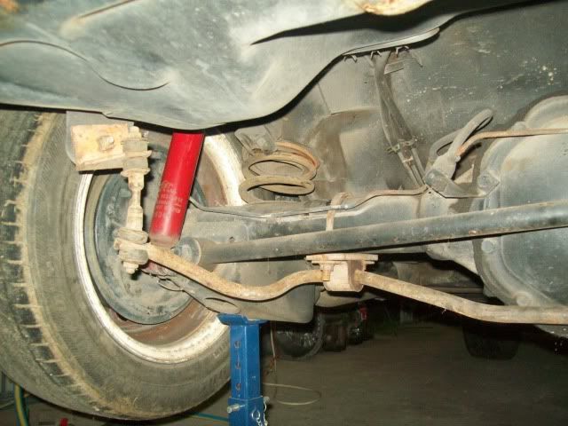

Rectangular Hollow Section (RHS)...
This is my old school K-Mac rear bar...
Works really well...

my whiteline bar is exactly the same as that too

Yeah I have a Whiteline that is also fitted in the same fashion except it has the adjustable end fittings, three holes in the bar end and a swivel arrangement pivot link mounted on an flat bracket again with three holes.

oh yeah, mine too.
is there an advantage of running behind the diff to infront of the diff like in late models?

i have a older style selbys blue bar that goes in the standard position , does fine

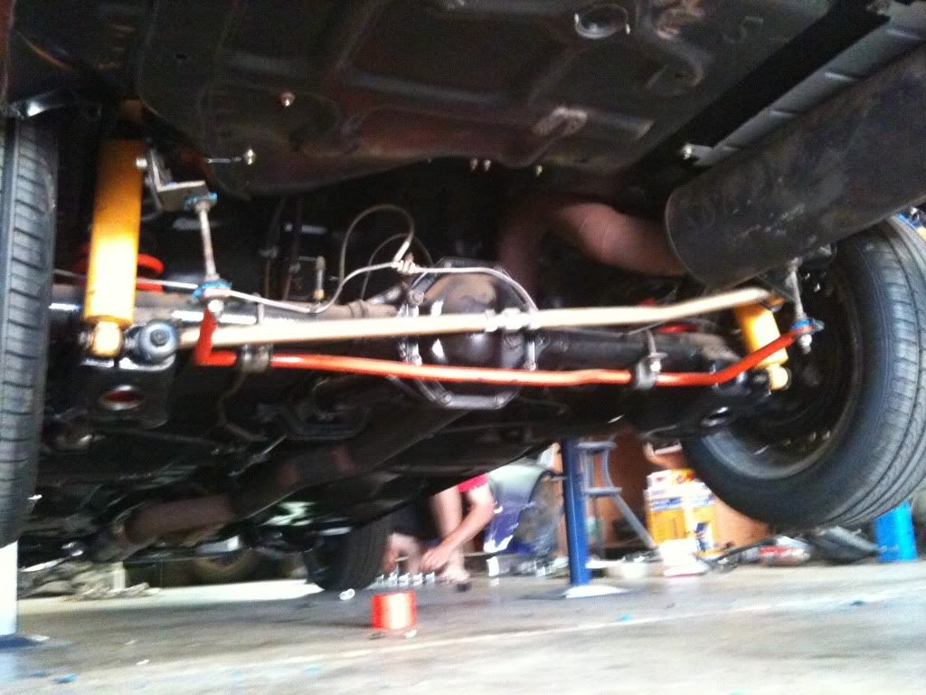

My sway bar

RHS = Rectangular Hollow Sections
they flex through the travel standard.. i just added another mount off the end of the other boomerang mount so it will move on its own arch
